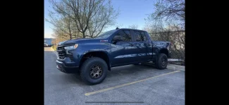

Finally made it happen. 285/75/17 Toyo Open Country AT3 C load, 17x9 MVX Off-road V62 -12. Slight rub on the mudflaps when reversing. Getting the Mcgauhgys mud flap delete should take care of it.

Wow, they look great. What is causing the rub?
Can you tell if a different offset would change that?
Seems like most guys can do the 285/70/18 which are only .1" less diameter, without rubbing.

a zero offset wheel would probably also help...but the -12 isnt hurting much. the MF delete or even a trim of the MF would most likely cure any rub
Thx
the -12 offset was causing the rub. Since then, I've had 0 offset wheels with 315/70/17 and it did not rub after taking the mudflaps off. Now I am back to 285/75/17 on factory 2024 Colorado ZR2 17" wheels and it doesn't rub either with the positive offset, mudflaps are back on.
