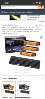

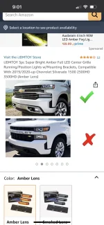

Okay so I want to do the amber grille lights like I have seen some people do with the LT and some custom but there are a lot out there and some have bad reviews. I wanted to do these but they say not for the custom TB so I guess the grille slats or something are different and they will not fit the same?

The grill slits/pattern is slightly different on the LT and custom.
I went with these for my custom TB:
I used the metal brackets the lights came with and some 3M tape and a black zip tie on each up behind the front of the grill to attach, will see if I can get a few picks when it's light out. Did need to add some wire to run from the lights to the battery and ground.
Have had them on since October 2021, went through a New England winter and are still working well.

Just saw these on eBay as well, which are the 1st ones I've seen specifically for the custom grill
They say those same lights fit a bunch of different stuff. I'm guessing you have to attach them with zip ties. I bought a set at my local supermarket chain that attach with double side tape. I'm waiting for it to warm up to see where I can mount them.
I used these with tiny black zip ties and they work and look great. I will try and get some pictures added to show how and what they look like.
awesome thanks! I def like those and I do not have to wait forever to come from China. They look similar and i am sure is better quality. I like they come with the zip ties and stuff. Do I need more wire to make it to the battery and I guess get a fuse tap wire
