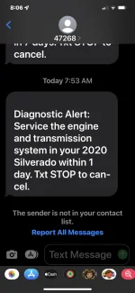

So, last night, the truck started ticking and shaking a bit, then the service ESC came on, then parking brake light. Parked it for the night, got up for work and left the house at 3 a.m, didn’t even get off our street and check engine light and transmission light came on along with the ESC and parking brake light again, only this time, it was ticking, shaking, and making worse noises. Turned around and parked it back in the driveway and waited for the local Chevy dealer service dept to open and drove it roughly 3 miles tops to the dealership to drop it off. Truck has only 20k miles. Anyone else had this problem or know if it’s a known issue?
Thanks!

Thanks!View attachment 3421
The ticking sounds an awful lot like a collapsed lifter issue. It's a popular problem with these new engines, unfortunately. It happened to mine, but I did not get those lights or anything else. Just the ticking and vibrating but it was definitely bad lifters. Should be covered under warranty either way, at least.
