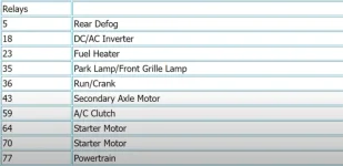

There should be a relay in the box immediately adjacent to the battery.
Thanks. Yea, the only relay in there related to fuel is fuel heater.
Just in case anyone else runs into this...the driver floor mat was barely pushing on the accelerator..it didnt even look like it was. Was causing the computer to think the engine was already running or something. Once i readjusted, started right up. And the dealer still has not called me back, big surprise.
