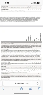

Looks like advanced trailering package, which in LT trailboss also requires convenience package 2 which I’ve also attached.

Those are just screenshots from chevys website for packages available for 21 chevys. Bed view comes with trailering camera package. I only have one camera on tailgate. I do not have advanced trailering package and I do not have convenience 2
That might be the OP answer then. I have advanced trailer package and convenience II package.
I probably made that more confusing than it needed to be, but I agree.
