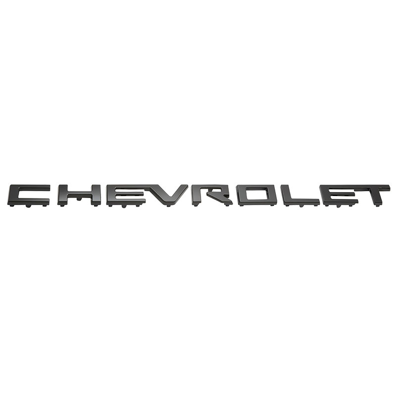

I believe they are inserts that clip in behind the grille, but I could be wrong. The pass-through lettering is otherwise definitely a part of the grille.
These are just letters. They are the same that goes on the tailgate
Highlight the Front Grille of your New Silverado 1500 with this Gloss Black Chevrolet Script Lettering Package from Chevrolet. This Genuine Chevrolet Accessories Front Grill Lettering package accentuates the embossed Chevrolet Script present on the Front Grille for Work Truck (WT), Custom and Custom Trail Boss Models. These durable and long-lasting premium letters are made of the same durable materials used on your existing grille. Simply remove the grille and use these letters to replace the existing letters. Front Grille Lettering Package includes lettering and installation instructions. Existing Grille is reused. Only for use on Work Truck (WT), Custom and Custom Trail Boss models which have the Front Grille with Chevrolet Script. ONLY for use on 2022 models (RPO J22, Engineering Year 2022) or VIN Digit 12 = 5 or greater. NOT for use on 2022 LTD models (RPO J21, Engineering Year 2021) or VIN Digit 12 = 4 or less.
Tailgate "Chevrolet" are just stickers, can't be the same. You can see the tabs in the picture.
Yeah, I posted the original link. They are plastic letters that snap into the plastic grille. If you removed the existing letters though, the grille itself would still say CHEVROLET so I'm not sure the OP is going to remove the CHEVROLET from the front of the truck without replacing the grille with something aftermarket.

Did mine yesterday. Instructions say remove grill, but I used a small screwdriver to wedge in the front where tabs are located on each letter, and they popped right out. Took me a bout twenty minutes as I was being careful not to damage my grill.
