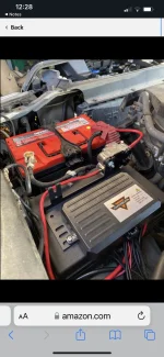

The last picture was not of my truck😂😂.. I was just using as a reference on where to mount.. Did not me to post that one
