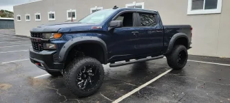

35x12.5’s no lift no rub. The front fender well I removed the rear fender liner bracket zip tied the liner back further. The front fender liner bracket I cut off and zip tied it more forward to give me the room needed. I put RC fender flares on which help give clearance. Otherwise you need to modify/remove the mud flaps the gain space. I also took out 1” in the rear because I don’t like the Chevy rake.

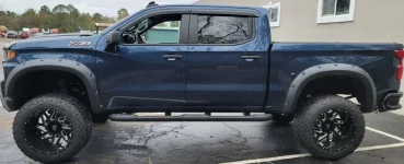

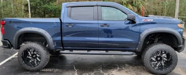

35x12.5’s no lift no rub. The front fender well I removed the rear fender liner bracket zip tied the liner back further. The front fender liner bracket I cut off and zip tied it more forward to give me the room needed. I put RC fender flares on which help give clearance. Otherwise you need to modify/remove the mud flaps the gain space. I also took out 1” in the rear because I don’t like the Chevy rake. View attachment 4610View attachment 4611
Thats a great ride. I'm looking at going with 35 as well with th3 ken block FUEL wheel.

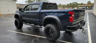

2021 Custom Trailboss, 22x14 w/-76 offset, 37x13.5 tires and McGauhy's 9" lift
