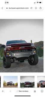

I’m definitely liking the cost alot better then the bumper I was planning on installing..The bumper and the lights I was going to order was 4200 dollars with everything.. Might change my mind and try the RC bumper.
Yeah, I was a little nervous about quality at first because it is so much cheaper than the other options out there but man...I'm really happy with this one. I can't see paying thousands more for another bumper and then still having to go buy lights separate (in most cases).
