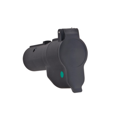

Supposedly this works. I found someone on another forum quite a while back and they were using it for trailers with LEDs since there were issues with it not detecting the trailer. If you leave this plugged in it should fake the truck into thinking there is a trailer plugged in at all times.
