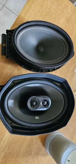

I just added 4 JBL 3 way speakers in all 4 doors from crutchfield and it was pretty impressive upgrade in sound and bass. No amp or change to head unit. Just need speakers with high sensitivity and then you could always add a sub at some point too.

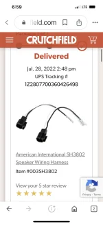

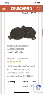

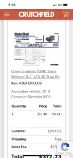

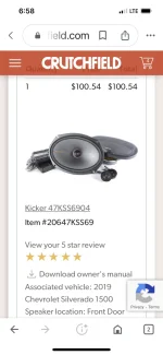

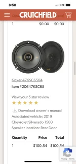

Everyting included. I called tech support late evening too for the tweeter wiring.

Nice, so was everything done at the speaker mounts tommy? Did you have to mess with the dash any?
Speakers mount in original locations with no mods. I also added baffles to each door speaker. The tweeters in dash are easy to get to, online vids !
Crutchfield will show you what will fit your truck and if any modifications are needed or not and recommend free wiring and brackets. Baffles i bought from amazon
