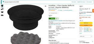

Yes 6x9s up front (w/ tweeters in stock location) 6 1/2 2-ways in rear doors. The tweeter mounts I had to bore out to do a flush fit and screw back in. I called tech support for the X-over set up. She had me reassured in no time. I used the factory wiring of the dash tweeters (cut the wrapped loom for slack). If I remember, wired the tweeters (only to x-over) and zip tied the box in the voids under the tweeter area after adjustment. After a test listen on the driver side I had to switch the wiring opposite of what the wiring online said for the correct output. It all went decently smooth. I did also put rubber baffles on all 4.
