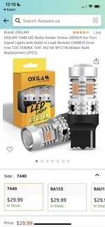

These are what I’ve been running for over a year without any issues.
I still have one good one if one of yours goes out. You can have it if you want👍
