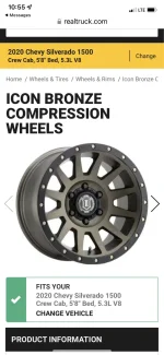

Just ordered new wheels … Icons bronze compression 18x9’s zero offset

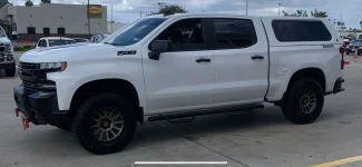

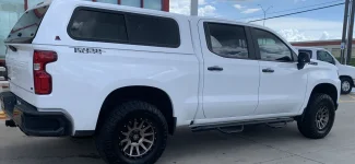

18x9 Icon compression dark bronze/black accents zero offset still on my 295/70/18’s…now just a touch of rubbing when reversing and full turn on mud flaps…
