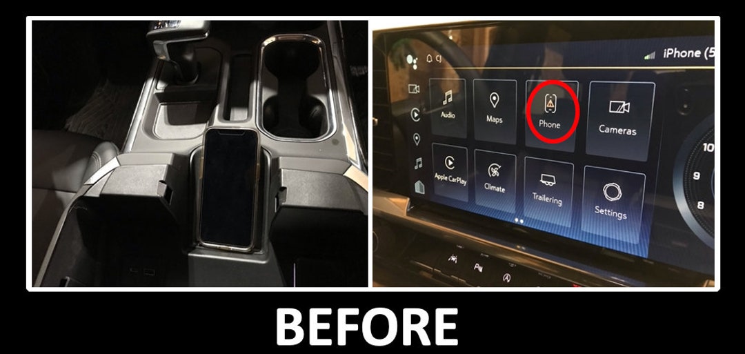

Anyone else have issues with their phone charging in the wireless console? I place my phone on the wireless charger and it'll charge for about three seconds then not charge after that. I have to mess with it and position it just right for it to charge. Most times it won't ever find the right position for it to charge. Just looking at some things I can do to fix this problem or if I have to take it back to the dealership. Thank you.
This was the easiest fix that I found for the refreshed models. I tried all kinds of different things and none worked for me except for this. Hopefully others see this and it works for them too! My phone is an iphone 13.
What year and model truck do you have?
Is this a 3D printed piece of plastic? Used as a spacer?
