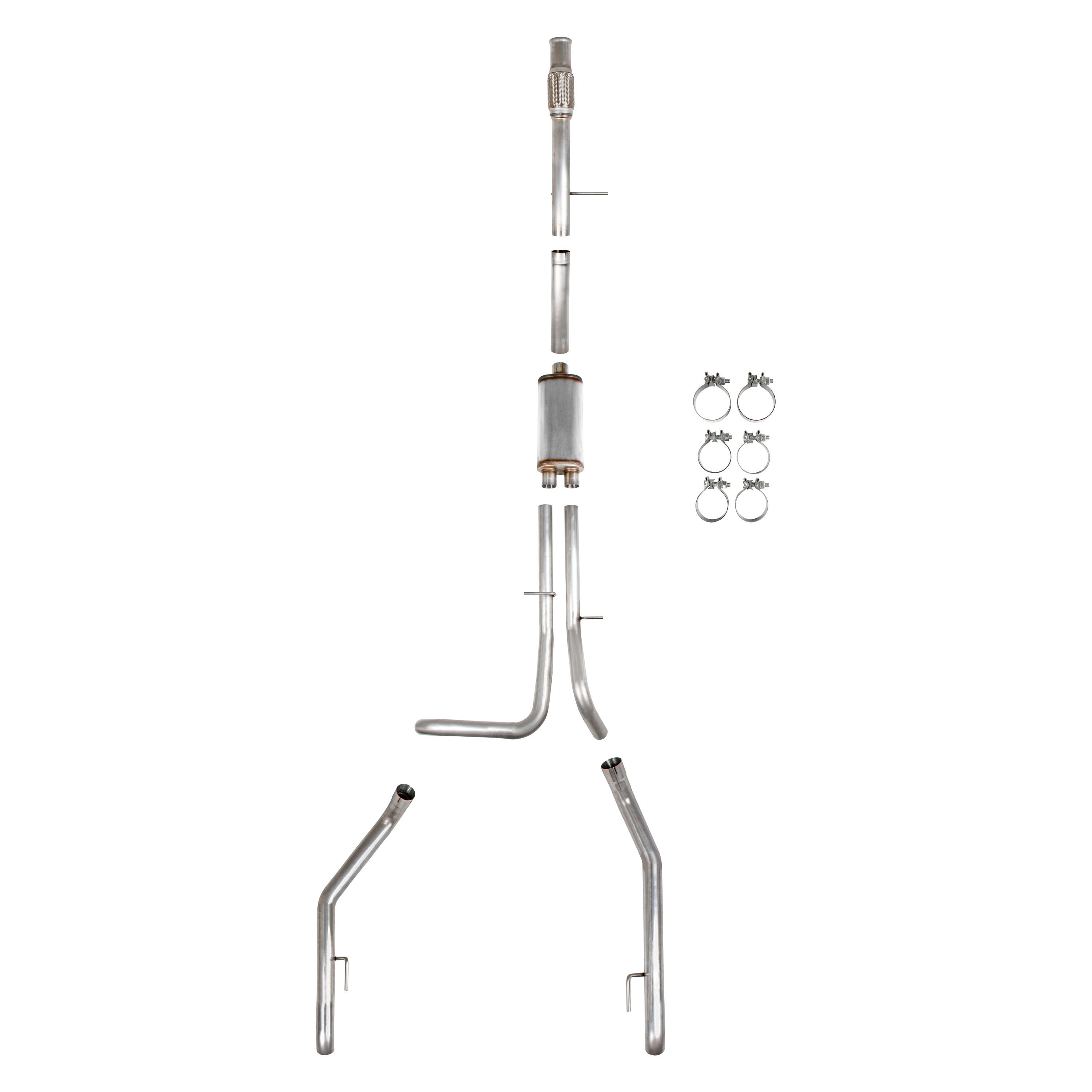

The same might be said about the Hooker Cat-back exhaust for our Silverado 1500 trucks (perhaps least expensive):
This is a very affordable upgrade. However ... the indication is that this is a VERY Loud and Aggressive sounding exhaust.
