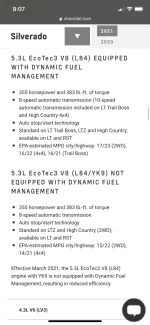

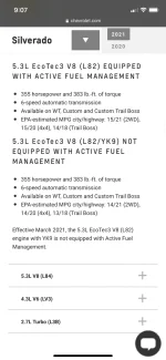

I did some research and my truck must have DFM. The 5.3 in the Custom is different than the 5.3 in the LT. The 5.3 in the LT has DFM unless specified that it does not. Mine does not show a credit so it must have DFM.
I believe that all the new v8s have the 10speed I know the custom and the Lt both do
The Custom Trailboss with the 5.3 only comes with a 6 speed forward gear box in Canada, to get the 10speed forward you need to move up to the LT TB, again thou this is what it is in Canada.
