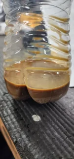

From a 2022 6.2 just under 10,000. I installed the catch can around 1000 miles and checked it at 8000 and it was full. I'll be checking it more frequently from now on.

It collects a lot of crap quickly. Get the can extension that doubles capacity. I'd suggest checking it 3-4K miles with the extended capacity. I was hoping I could make it between 6K oil changes without emptying the catch can with the extension, but the first time I tried it, it was totally full.

I have a 19 TB custom 5.3 and I empty it 2500-3000 mi. w/orig. can.

i have the extended body, it fills the original can at 6K miles.
