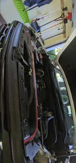

Regarding the Stillen air scoop, I looked into that over a year ago and learned it's only for the trucks that don't have active shutters behind the grill. If you have a active shutters you'll need to modify the stillen scoop to prevent the shutters from catching on it.
I put the stillen scoop on and noticed a difference after I removed a piece of plastic that sat over the radiator so more air could get through....
They modified the Stillen scoop so it clears the active shutters now. I had no issues with mine. They also updated the description on their website that it now fits trucks with active shutters. I did remove the top shutter on mine so that it's always open for airflow instead of being blocked off when the shutters are closed. Didn't make any difference in mileage and probably none in power either.
