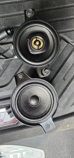

I did pioneer 2 way speekers in the dash as well. Definitely much better
