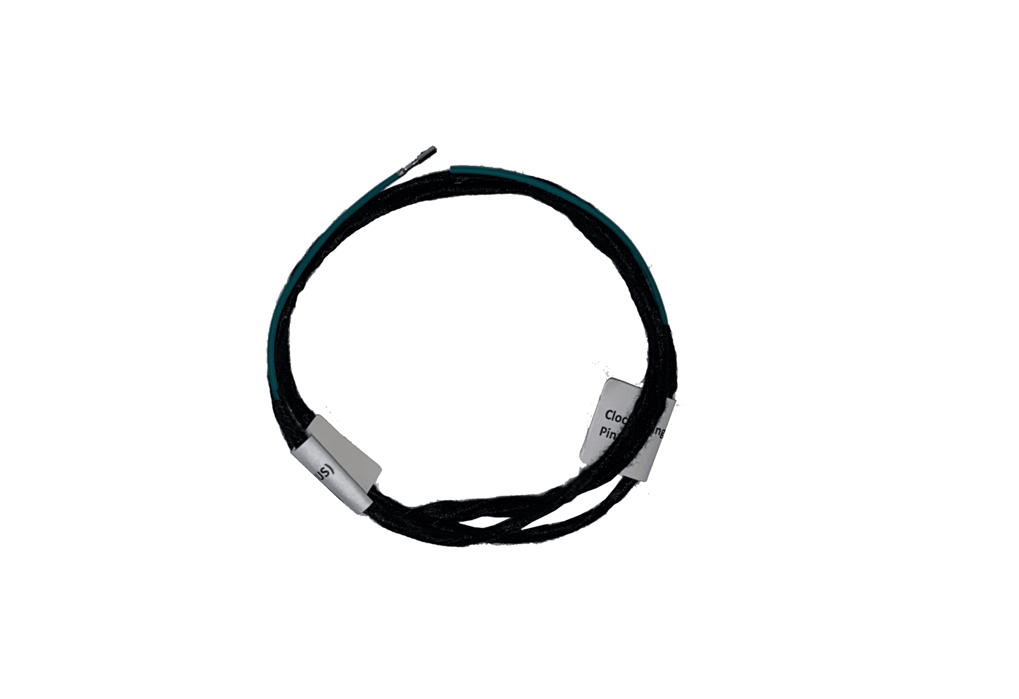

Installed the Denali gauge cluster, new steering wheel and harness to my TB Custom and now have a sweet looking cluster and fully functioning steering wheel with all controls! Much needed upgrade!
Now just to figure out how I can get the heated steering portion to work. Maybe find the wire in the harness and hook it up to a 12v source?...
NM my previous message, found a video with the single wire install

could you guide me to a install vid for the harness for radio, trouble finding one. I just replaced my wheel on my 19 custom. thanks
Are you referring to the Harness Dr harness for the steering wheel controls? If so he has a work instruction on his website.
I hope your eyes are better than mine. That wire is a lot smaller in person. But it’s definitely worth it once completed.
yes. I did find another online finally that was very well done and up close. on the Drs site I did'nt scroll down far enough. thank you
