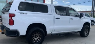

I put Toyo 195/70's on mine. So, 34X11.5 roughly. I had to remove the mud flaps when I added Bushwacker fender flares. When I added the tires I had to remove the mudflap brackets and add 2" wheel offsets. When that was done I had no tire rub. Before the spacers It rubbed bad. Hell of a racket. I've read on the GM forums that you could put 195/70 without any rubbing. Anyone who says that is wrong.
Looks really good! Do you have a level kit or any kind of lift on your truck? Also, can you please provide info on the wheel spacers you used?

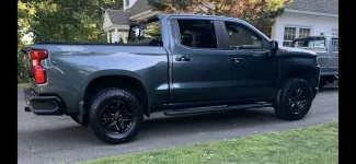

I ended up having the 295/70’s mounted this week and can confirm there is no rub without spacers
Could you post some close up pics of your wheel and tire setup, definitely looking at going this route.
I know it’s a cost but getting the proper wheel offset to achieve the proper stance and control arm clearance. is best over spacers .. it’s so obvious when running spacers on stock wheels,..but I understand it’s an expensive expense buying a new set of wheels … and the gloss black trail boss wheels are very nice but not their positive 26 offset…just had my new wheels installed (ICON zero offset) , been out of town will post better pictures gents.
