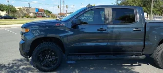

I have 35x12.5x18 BFG KO2 on stock rims. I only have .5" front lift. I clear the wheelwells and the UCA with no wheel spacers.
Your tires look ridiculously huge the way they fill the gap. Looks good. I'm not sure how they don't rub, even at full lock reverse or off-road?
And how do you lift it .5 inch? Shock adjustment?
I had a 34x11 inch rub when I had them put on a full lock. Hit the fender liner in full lock reverse. Bone stock. I really compressed the hell of it to see, pulled it up on a curb too and it looked like it would rip the liner out with any amount of speed.
I had a small lower spacer in the tool box and I added that. I think it was .5 or .675". I did trim my mudflap and pulled back the liner. I don't do alot of heavy offroading so I would guess if I did it might rub.
