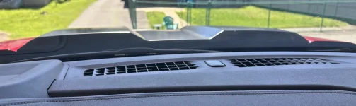

New Hood Scoop - Eliminate Blinding Reflections
If anyone wants a set, i could do for cost (of the vinyl) plus shipping. Vinyl cost is about $1.75 and postage would be whatever USPS charges... I am not sure how long my vinyl will last in the elements, but for the cost, it will be easy to replace.
Has anyone thought of scuffing that place with sandpaper and making it dull?

finally gave up , gonna spend a few hundred $$$$ to get the thing painted matte black by a body shop , I ain't taking the hood off to get decals to possibly line up and then fade and / or peel off , already wasted $35 once . I don't have 4' arms to stretch across the hood and possibly line em up . So taking the easy way out and doing it the way it should have been done to begin with
How is the scoop attached to the hood?
the hood insulator pc is help by clips just pop em out , the scoop is held on by by a few clips and threaded pcs that you have to unscrew . then you have the fun of compressing the clips and popping off the scoop. may want to people , 1 to compress clip and another to use a plastic wedge to help pop the scoop, thats how the body shop did it , then i got my truck back while they painted the scoop satin . No more glare and to me looks 100 times better
