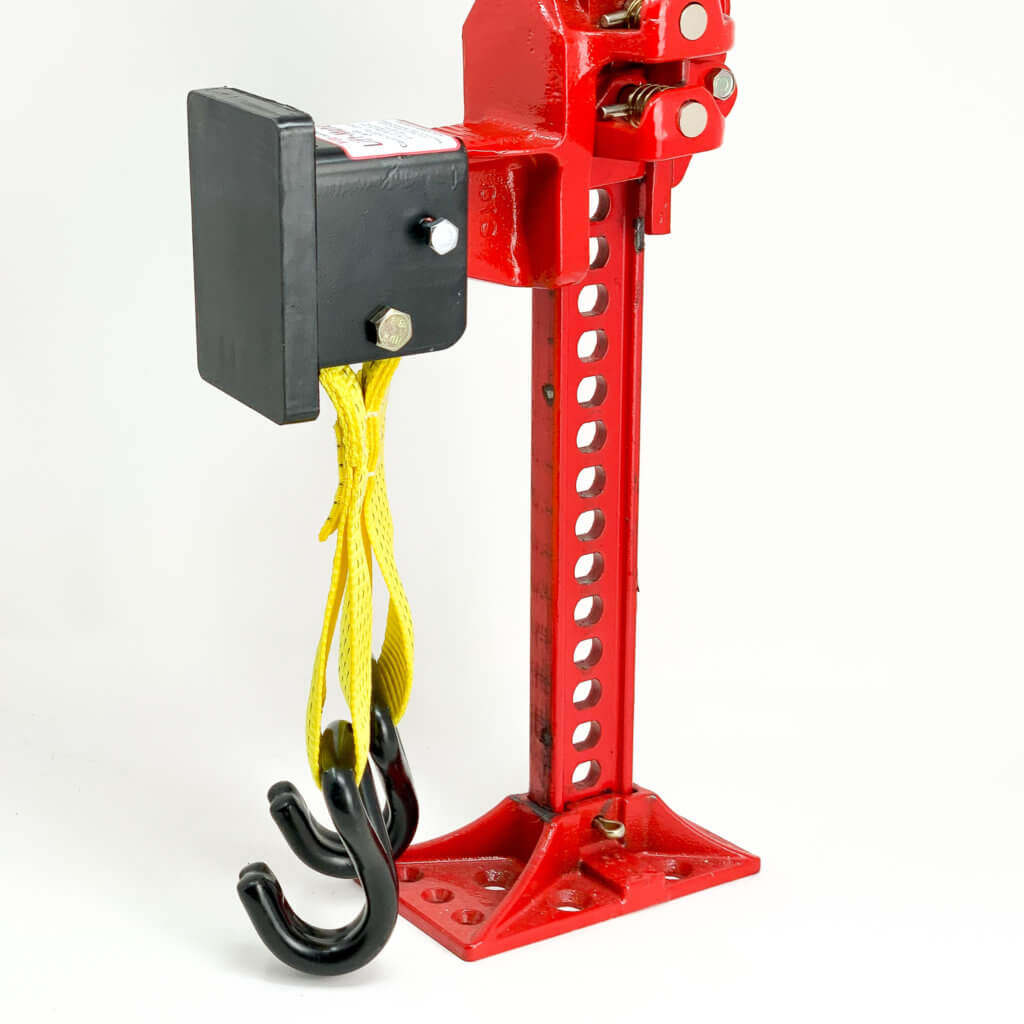

If you could lift the corner with the flat/ruined tire off the ground, then place a jackstand/bottle jack under the truck, fixing the situation would be possible.
That is what this accessory allows: lifting the tire by the Wheel. So I have started carrying a good jackstand when I take the Hi-Lift/Farmers jack.
I also take sturdy squares of wood (16 inches square) as additional Base Plates for the Hi-Lift (besides the plastic one) and the Jackstand, for soft/sandy terrain.
However- this thing can also be dangerous. Parking brakes do not hold a Front Wheel. When I used the combination on a front tire (Corvette) the tire/wheel began to turn away from the jack. Not good.
Our trucks would be safer: Put the truck in 4WD Low before lifting. All wheels are Locked in doing so.
(The 4WD-Low is a feature the vette does not have.)
Also ... Member MrColieman posted this on Oct. 3rd (Vehicle Recovery Gear thread) regarding an Adapter that he invented for the Pinch Welds.
One of these may be my next Welding/Plasma Cutting/FabriCobbling Project.
What cost Convenience?
I could drive all the way across Denver metro to a yard where I can probly get the 3" x 2" rectangular steel tube cheap. Or ...
I can order a 12 inch length priced at $22, and shipped for another $22 ... is it worth it?
The LiftMate was about $60.
