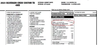

2023 Custom with DFM
I have a 2024 LT TB with the 5.3L and the window sticker says it has the DFM. However, I’ve never seen any indication on the dash when active. Is that normal? On my RAM Rebel it says Eco on the dash when activated.
There is unfortunately no way to tell if the DFM is active. Some say you can hear it in the idle exhaust tone "helicopter sound", and others will say you can actually feel the cylinders fire up and drop; but there's no V4/V8 on the DIC like the old AFM vehicles had.
The previous generation Silverado's and Sierra's would have a green "V4" logo that would pop up in the bottom right-hand corner of the dash gauge area. But there is no indication on these new ones. If you have stock exhaust, you should hear it as you are coasting to a stop. Many mistake it for down-shifting, but you can hear the engine popping back into full V8 mode at about 10 MPH as you stop.
Thanks! It's a new truck so I have yet to hone in on the engine sound but will start paying closer attention.
