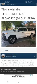

I've read countless threads on this, I have the rc leveling kit and my next tire will be 285/65/20. Here's my truck leveled, stock tires on 20s. And white truck image is from a forum. Imo, the 285s look just right, not too big, not too small. No trimming no rubbing as reported by that owner.
