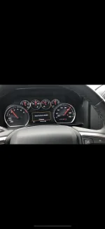

After you reset the speed are you hitting the Cancel Cruise button and letting the needle sweep to 140? That should indicate that the change was accepted.
Sure am. I got a reply email from tech support. Couple other people are experiencing the same issue.
That’s reassuring… I guess we also just have to trust them that the DFM is truly disabled too. Nice.
Only way I’m knowing is I don’t get that annoying helicopter exhaust sound cause my Borla Atak muffler is loud. I knew right away when it would kick down to 4V
I to am having the speed limiter reset back to 98.
Also, my TPS monitor thinks my tires only have 31-32 psi in them. Usually it just the front, but sometimes it's the rear too.
I did a relearn, no help. I've tried setting the tire psi up and down with no change in behavior.
My tires have 35psi and nitrogen in them, they don't change.
I'm going to try a call to Diablo sports tomorrow, see if they can help.
So weird. I haven’t heard anything back yet about the solution
I called Diablo sports yesterday, they hadn't heard of the TPS problem, but the speed limiter resetting they know is a common problem.
They are sending a update cable and I'm to download a patch that might fix it.
I wish these companies would debug these electronics before the sale of them.
